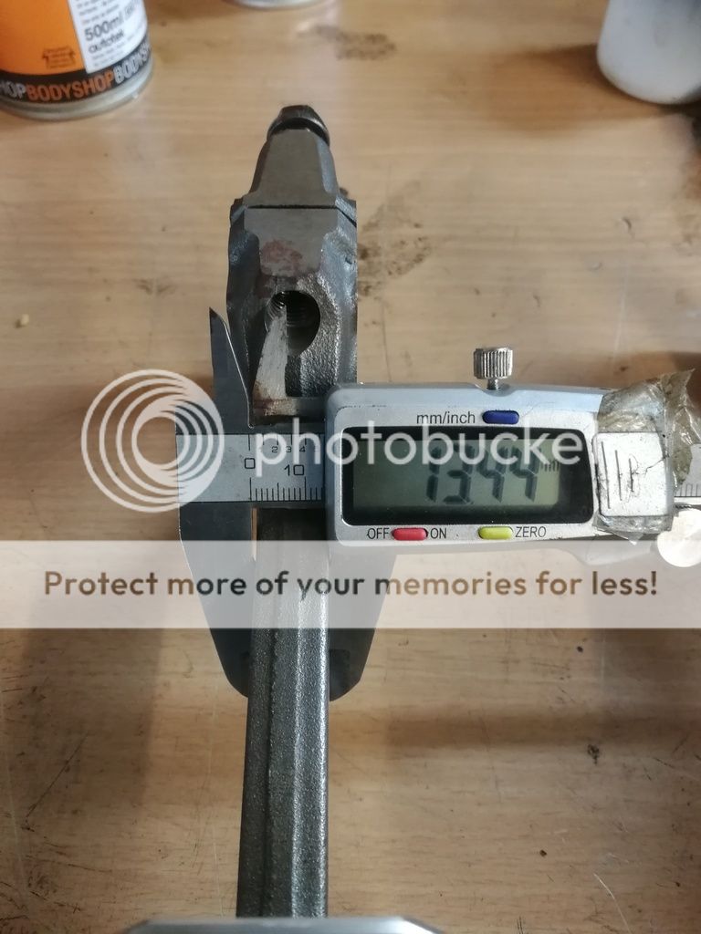

  32. and someone on here said the 225 and 250 rods were the same size :openmouth:
    225 rod
    250 rod
    Genty, markoc, Nigelo and 1 other person like this.
